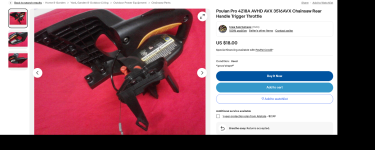

I found a seller on ebay, selling the handle and cable assembly for $20 and a few $ shipping 1707535730216.png
