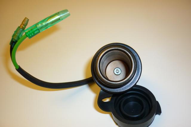

Excellent. Thanks for the links. It appears that the wiring harness merely clips to the battery terminals. What I had in mind was installing some type of electrical outlet on the body of the mower with permanently installed wiring to the electrical system. The wire to the pump, with an inline switch, would plug into the outlet, making the whole setup easier to mount and dismount. I might even mount the switch on the body as well. Do you think this might be feasible? If so, do you think any particular type of outlet/plug would be best for the application? I probably could find something at Radio Shack or someplace that specializes in RV or trailer parts. Again, thanks.
midnite rider
Nov 25, 2011
31
1,638
What I had in mind was installing some type of electrical outlet on the body of the mower with permanently installed wiring to the electrical system. .
Some ideas for you.
Rivets
Mar 11, 2012
60
15,501
How you hook it up will depend on how much you want to spend and how handy you are. I used an auxiliary socket like midnite rider pictures on three tractors so the unit can beceasily switched over. One customer had me wire the switch on the dash board and another wanted a lighted switch mounted on the fender. One thing to remember, you must leave slack in the harness, so there will be no strain on it during turns.
