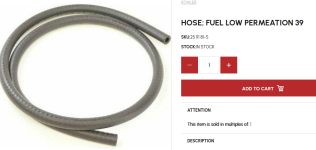

Alright you guys, I have searched forever for this one simple part. I don't know why it's so impossible to find, but it seems to be. I have a Cub Cadet XT1 Enduro 50", and it has been mostly a <fkn> lemon since I've had it (about 9 years?). ANYWAY, I had a hose rot and the mower wouldn't run anymore. So the hose runs to the top of the gas tank, and then into the air filter area. Without it, the engine will run for a bit but then sputter out. My searches have suggested that it's an EPA EVAP hose, but I have been unable to confirm, and unable to find one for purchase. I found what Kohler showed was the part, and the part number, but nobody sold it, and I had to go to China to finally find one. When it eventually came in, it was like 5 inches long. This thing is supposed to be like 4 feet! Can someone PLEASE shed some light on this?! I really need to cut my grass.
See if this is the hose
