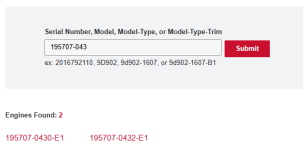

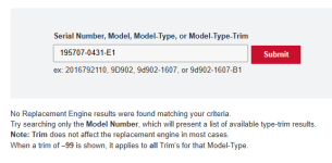

Replacement engine information ( read to the bottom):
1731781470834.png no exact engine replacement, so per the noted:
drop the ...1-e1:
Your local B&S dealer can help you further. The other spec details may be a better fit - again, local dealer...
