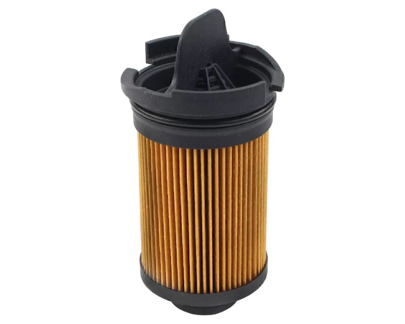

curious if any of y'all know the part number for the new Oil filter Xtend on the CXi engine? https://www.briggsandstratton.com/n...ng-lawn-mower-engines/cxi-series-engines.html
696854 standard yellow filter they have been using for years.
I think this is what you are looking for. If it's the cartridge style.
That is for the dry sump engine that can operate at 45 degree angles. Has an external 5 quard capacity tank.

Scrub do you have an model and type number?
As there is two different setups. There is standard oil mount and an optional remote filter mount. The 44T9 that I look at only showed the standard filter. Now the one MParr posted is from the 49E877-0010-G1 that has the optional remote filter. But there maybe another design out there too as I have yet to see this setup in my shop. I am always several years behind being an independent shop. This is why a model and type number is important so I can lookup the IPL to what the setup is. I just don't like just throwing something out there.
Examples of the CXI two filter systems.
View attachment 72098View attachment 72099
I do not, but it is the engine on left
