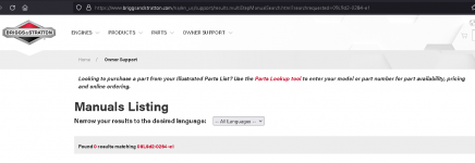

Please check your post information vs the engine in this post. I think you are advising the OP to hydro-lock his engine but it may just be my brain being flooded with all the rain here this morning.
I can't pull up his engine on the Briggs site. Looked to me as a 9ci 3.5hp engine??? You might be on to something Star Tech?? I don't know if he has a H or V crank either??

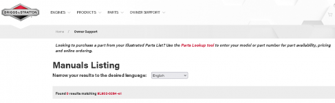

That is a routing error on Briggs site due to having select what the engine is on. Kinda dumb idea on Briggs part by programming the search engine that way when we don't what the engine is on. You kinda have to take an educated guess as to what it is on.
If you select "pressure washer" instead of "push mower" it will come up with 12 results.
