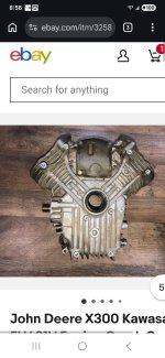

Here is a pic of a bare block. The plate with 4 screws is the breather. Usually when they leak the air off the flywheel blows most of the oil down the left cylinder. You need to remove the intake manifold and the flywheel to get to it.
