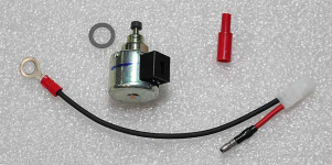

What I believe is happening is the solenoid has failed ( or the wiring to it ) so the engine gets enough fuel to fire at cranking speeds but not enough to run at idle speed .
As the shop fitted the carb I would hope it is a good one .
If the solenoid has a single wire to it check that the carb body has a good ground
If it has 2 wires check that the ground side of the wire is still connected to the engine .
Also check that the solenoid retracts fully when the key is in both the start & run positions
As the engine swap was a Courage to a Command then there should be no wiring problems other than a nut that was not tight or a ground strap on the carb omitted
My issue is that my carb has no solenoid 😅 I'll try that I appreciate you both. I'll keep you updated! Thank you

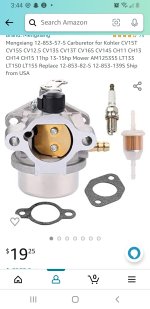

No sir, it took me forever to figure out it wasn't the same engine as was made for the mower. But this is the one, starting fluid worked, I called the shop & they picked it up for a 3rd time lol. They said somehow its not getting fuel and will check for blocks I mean. I could do it but they should have done a more thorough check the last time. I appreciate everyones help, will update when they call me with the results lol

Chi-sneeze carb was brand new. In the mower world, Chinese carbs are a gamble if they work or not. Either clean and fix/repair the OEM Kroller or buy a new OEM Kroller carb.
