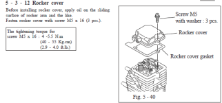

Try this. Should be what you are looking for...Different four stroke Makita but according the IPL looks like the same setup.

  • / Need help setting timing on Makita four stroke bush cutter
I will give it a look first thing! The pics looks a bit unfamiliar but as long as I can find the coil mark I should be fine.
Much appreciated, I will let you know.
