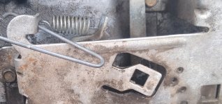

I finally think I got it ! Does this look right ?

The spring does not go the carburetor but on the control bracket that I posted a picture of from my personal mower.
hi StarTech, I was wondering if you ever took a look at where I put the spring, I think it's right, but unfortunately, I can't start it up yet to find out, because I have to get a new battery. thanks
Been very busy here. Just looked at your picture and the spring is connected in one place but it is off toward the carburetor instead going down to the governor arm. Also the choke linkage is incorrectly installed. It will never work as in the picture.
