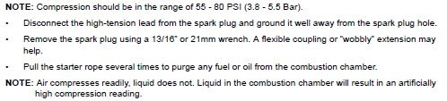

What results should I expect to see for compression for this single cylinder horizontal 4 cycle OHV.

Do you have more than 50 PSI compression?
