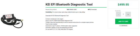

I think I read there are 7 sensors on the EFI engines, and there really is no way to check them without the software. I didn't know if there was anything else I could check on the engine.
110
12,223
And it not just the software you need but the electronic interface. And is fairly costly except for the dealer that can justify the cost. But the software is cheap that goes with it is cheap.
Which why I have not purchase it myself as first I got to start seeing the EFI engines in my shop first. Then I will part with the $410.

Naw, haven't yet. 2 3/4" - 3" is kinda standard cutting height here. Lots of centipede grass and most like it short, some down to 2 1/2". It does ok that short. But planning on taking mower to dealer next week after the first and let them connect to computer. Engine is EFI, and I think I read where it is a wireless connection. Of course, they will charge me for an hours worth of work for a 10 minute thing. But hey, that's ok. They have a lot more overhead than me.
