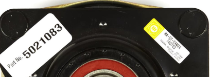

When you pull the old PTO clutch shoot an image of the label on it and post it. I would like to see who made it.
It think it is going to be a Warner 5215-85 clutch.
Finally found a decent image of the label
It is a Ogura MA-GT-EXM3X
Which Xtreme X0936 is one of the replacements.
