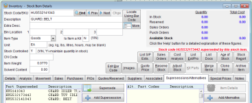

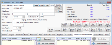

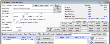

PN 193414 has been superseded a couple times. > 532193414 and 531148901 is the service kit.
PN 169022 has been superseded to 532169022
PN 532173442 has been supersede > 532141043 > 531165901
Even the following website which you can get the original part numbers which I still need to run through my database to get the current part numbers but the Sears site don't list have all the part numbers listed or at least they didn't this morning. They also list the parts as NLA but that is just because they don't have access to the Husqvarna parts.

Bert, Poulan is owned by Husqvarna and Husqvarna uses the same part numbers.
As for having an updated list it is what my distributors provides me as price files with supersedes which I load into Adminsoft Auto Manager / Accounting software I use here. Currently I have only nearly 1 million part (SKU) numbers that are cross referenced and still SKUs that I must add manual or manually cross reference. Of course I have to delete last price update column and a few other columns that my software don't need. Now of course I have my own prefixes assigned just in case there are duplicate PNs by multiple OEMs.
I have loaded MTD, Husqvarna, Stens, and Rotary price files along many of the other OEMs my two biggest distributors provide parts and price files for.

Yes I understand that different areas have different setup for looking up parts. Plus Sears has gotten very lazy about their equipment IPLs.
And yes this particular deck was sold without belt covers which was a safety issue but many customers simply don't care about safety. It is just the deflector chutes for the discharge for the clippings. Some has to be there no matter what as there is large hole that the operator put their foot through. Some deflectors are too large length wise and can be shorten with reason.
The PartSelect site does show all the referenced parts and it take a little more effort to look the original numbers and then cross to the current numbers but I am use to having to research things to an extra level as I get some fairly old and odd equipment here. But to be honest this particular deck is a new one on me.
I usually use Ereplacementparts.com when I need to cross reference a particular part as in this case the deck shell fits the following mowers which get you easier to the current part numbers.
