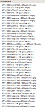

My brother needs a Kohler Part # 3202521S Flywheel Assembly. I am not sure what engine he has.
I find them for around $200, but he would like to find one cheaper from somebody who is salvaging small engine parts, if possible. His mower is pretty old and he does not want to put a lots of money in it.
Like this one: Link
His old one has some teeth broken. I see the following note and wonder if that is the reason they changed to steel: "Kohler has changed from powdered metal ring gears to steel ring gears."
Anybody got any suggestions on a source?
Many thanks.
there may be a ring gear replacement for your flywheel
Thanks. I will explore that. That would be a much better solution.
I stumbled across the following note in the Kohler parts web site for the flywheel:
That might explain the reason for his broken teeth.
I also found this in the factory manual:
"Inspect ring gear for cracks or damage. Kohler does not provide ring gears as a serviceable part. Replace flywheel if ring gear is damaged."
Maybe somebody makes an aftermarket ring gear or maybe I can find one on a junked mower.

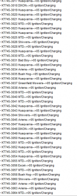

It's hard to know what these fit: Link
