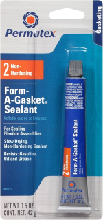

I've gone to the non-hardening sealants with great luck. Much much easier to remove and clean up for the next guy.
