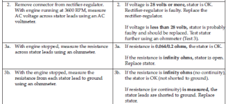

first lets some testing if you got DVOM.
And I see that you replace stator. So if test 2 indicates bad if probably the flywheel magnets but step 3a and 3b still need to done.

(2) With the engine running full throttle, I checked the voltage across the two outside connectors of the Stator (both AC voltage) and my numbers ranged from 42 V-38V down to about 5 volts. The number changed as the engine surged (slow down the voltage dropped).
(3A) With the engine off/key off, i checked the resistance between the same two stator leads. I was getting 2 ohms, which I believe is ok because I would change the multimeter setting and it kept showing 2 (different decimal place). So I believe it is ok. Again, brand new stator installed.
(3B) With the engine off/key off, I tested each stator lead directly to the battery negative terminal. Infinity so no short.
