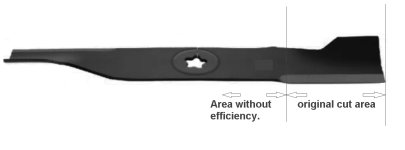

I just don't think it's necessary to sharpen much beyond the original size.
Thanks Bange,
That was the original edge length for the Honda HRX blade. I didn't add anything to it.

I think we all know that the end of the blade does the majority of the cutting, but I'm curious as to how blade manufacturers decide what length to make the edge when the blade is made? I've read advertising BS regarding an "extended cutting length" on a blade that had an edge all the way to the center hole, which accomplishes nothing. I've even seen pics of blades where the cutting edge extended past the center hole, which I guess technically accomplishes less than nothing since anything on the other side of the center hole is moving AWAY from the grass as the blade spins.

Excuse my ignorance regarding your original blade... I've seen videos where people sharpen beyond what is necessary or efficient.Área de afiação.jpg
Mer2112
Feb 5, 2023
Excuse my ignorance regarding your original blade... I've seen videos where people sharpen beyond what is necessary or efficient.View attachment 64195
No worries, I agree that anything beyond the few inches at the end of the blade probably isn't doing much.
