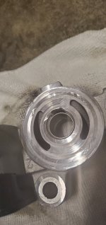

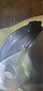

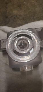

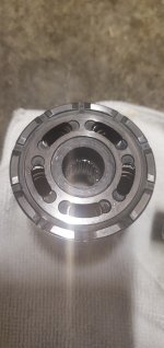

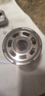

So I finally cracked open the bad hydro assuming/ hoping the center section would be shot and the fix would be a simple part swap but it looks to be in good shape. Everything passed the fingernail test, nothing really caught my nail. Now you can see circular marks on both ends of the section but, again, nothing feels rough. I don't know if the microscopic sized cracks/ grooves would be enough to make the right side stop working. I don't know what else really goes bad on these things. Im stumped. When i drained the oil, i got about 1.5qt out of it which tells me that it really wasn't low on fluid. The oil did seem sort of milky in color. I'm not sure if that could mean anything or if it just needs changed. There's a few small shards of metal on the filter magnet that I'll attatch a photo of along with pics of all moving parts. Any help and advice is appreciated

Stuffed with a capital S
In photo 3 see there is a track from one slot to the other
On slot is the oil in & the other slot is the oil out
So rather than work the piston ( or build up pressure ) the oil passes directly from one slot to the other
