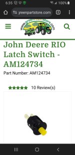

Thank you for all the replies! I pulled off the relay and tested it and it is working fine. None of the wiring looks as if it has been modified or messed with. I tried starting the mower with the reverse switch pressed and it started no problem. That would be the same as having the jumper attached, so I am baffled at that. But, since the switch seems to get wacky while I mow and suddenly not work I ordered a new switch to see if it solves that problem at least. I'll try again with the jumper and see if it still effects starting and check back.
Thanks again for all the help!
fergy59
Mar 21, 2018
17
New RIO (reverse implement operation) switch installed and I mowed the entire half acre with no issues.
