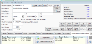

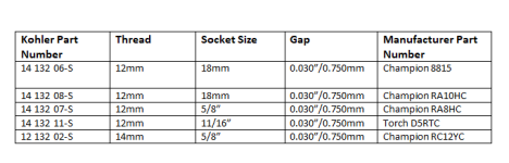

I'll check my Kohler plug cross reference list when I can find it and post back but if this is the plug with the 12MM thread size that plug was made by Torch specifically for Kohler and as of 6 months ago there was no alternate. If I find something different I will post again.
Okay found it. Torch part # D5RTC.

Kohler has at least 4 different plugs with 12mm threads but no replacement for the 14 132 11-S. The other plugs will fit physically but the heat ranges are different and using one of them in place of the 14 132 11-S is not recommended by Kohler. This info is a several months old so I can't swear it hasn't changed but this was accurate as of the first of the year.
