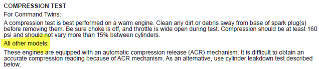

As i have understood from service manual ( http://www.kohlerengines.com/engines/onlinecatalog/pdf/sm_62_690_01.pdf ), it has ACR. But when I pulled crankcase cover and took cam out, I was surprised. Didnt find anything related to ACR.

First you must re-read the manual. You have a Command which uses hydraulic lifters and there is no ACR involved.
The section you are referring specifies Command vs all other Kohler engines. Even the single Command engines don't have an ACR.

Thanks. My bad then - why it is so hard to read manuals carefully :D Well at least experience is gained.
