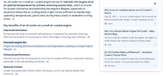

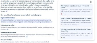

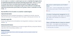

I suggest, if you haven't already, Google "purpose/benefits of oil cooler on small air cooled engine."
All of this is from Google using YOUR search words. As we will see, I captured every paragraph link and posted here for all to see. Notice the SOURCES on the right side of the screen grabs. None are credible.
