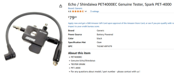

Do you have an inline spark tester? The one that looks like a troubleshooting current tester? Install between the ignition wire and spark plug, go attempt to mow and see iof the spark drops out.
That is a tool for checking spark. Is it the best tool for checking spark, no.
Why - spark can fail at mid and high revs where the light bulb type will not show. Taryl on youtube has a video showing this exactly. These types below are superior spark testing tools.
