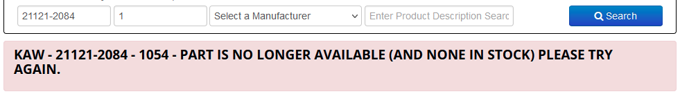

Houston, we got a problem here. The 21121-2084 coil is NLA from Kawasaki.
this what my distributor has posted.

I am planning on testing it tomorrow after I get off work. But for giggles I tried to find a replacement ignition coil, to find an idea on what it's going to cost. Apparently I can get one from John Deere,
But it is expensive lol
