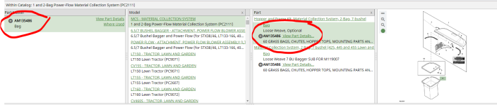

The issue here is airflow. The factory bags will handle grass no problem, but the more you use them, the more the holes in the bag weaving get clogged. It's not noticeable when bagging grass usually, but can make bagging leaves a challenge because the leaves are so light. So, Deere has 'loose weave' bags to help with this issue. Essentially, with the loose weave bags, the thrust of air that the blades are creating can escape faster, thus increasing your 'suction' power for the leaves. See picture below. Also, make sure that the bagging blades GX25668 were installed when the dealer installed the bagger. I've had situations where they forgot to change the blades. The bagging blades have a higher lift which creates more air flow. Hope this helps!

Hey Will: any comment about the number differences from previous email? The Loose Weave bags AM135486 and AM135485 seem to meet on my research. My JDX330 /42" deck has a 2 bag system.
Will both work? The 485 includes the X330 in its fit list; the 486 does not. This lack of pick-up occurred on the first cut with a new machine and bagging system. The bags may already be loose weave but cannot seem to find part number. Please advise. Russ

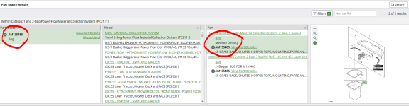

Sorry for the delay. My notifications never work lol. See part differences below:
Will: my Material Collection system is a Powerflow, therefore,the part # is Am135485. I looked at the bags today and they seem to be of the Loose Weave type. Russ Stangl Oops, after looking at your attachments I see that they actually medium density. Thanks for the great help. Will get a set shortly

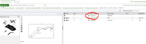

You're welcome. I assumed you had the standard 42" mower deck, but you have the optional 48" mower deck. My bad. I missed that. The loose weave bags will definitely make a difference, but if they don't totally fix the issue, I would get the deflector kit below.
G'day Will, Actually I have the X330 with 42" ACCEL DEEP deck. The POWER FLOW system is without the blower. It really does a good job filling the bags; the frustration is the leaves and grass being blown out the front and piling up on the deck surface. I will get the loose weave bags as soon as I can and get the deflector kit if necessary. Once again, thanks!
