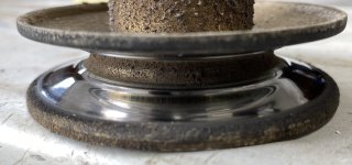

I pull the deck off this morning and here is what the drive pulley looks like. There are ridges in it also. The plastic idler pulley looks good.

Yes, I put a JD OEM belt on last year. After taking the drive pulley off I removed the transaxle. The driven pulley on the transaxle is also shined right to the bottom. I’m going to replace all the pulleys plus the idlers and belt.
