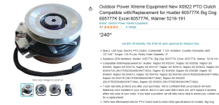

I've replaced a few but $780 is WAY too much , look on amazon

Stens do an aftermarket one part No X0922 which is listed at $ 733 with free shipping from All Mowers but it might not get here for a very long time as they are hopeless.
I could do it for you for $ 550 + P&P but Stens list it as currently out of stock with no ETA and I know All Mowers do not carry any parts so they will tell you they have it , take your $ 733 then a month latter tell you it is on back order .
So you might be stuck with Genuine Hustler only if any dealers have them in stock which is very unlikely .
Hustler used to be handled by RGS but from memory has now been picked up by Masport so there may be some dealers stock but I doubt it
And unless your Hustler is a current model they most likely will not carry any parts that are unique to it because they are not liable for supply parts for wholegoods they did not import .
RGS has no stock either but they do have a 6 1/2" pulley one in a Warner clutch but that is more expensive than the Stens
I could do that for you for $ 600 + P&P and it will take a week as it has to come down from QLD
This should work with your existing belt but the blades will spin a bit faster
This is the base specs of the Stens clutch.
  • Belt Width1/2" or 5/8"
  • ID1 1/8"
  • Pulley Diameter 6 1/8"
  • Rotation DirectionCounter Clockwise

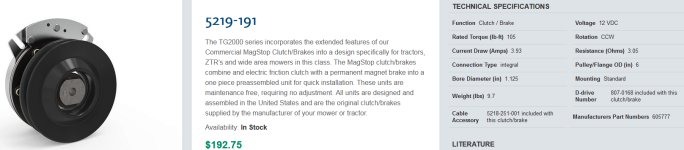

It is a Warner 5219-191 clutch so search for its replacement or visit your local mower boneyard. Looks like was made just for Hustler so it will be pricer.

The problem is the OP is in Australia and not US based so his sources are quite different than our US base sources. Also exchange rates and other fees at considerable amount to the costs.
For me I would be replacing with the original Warner clutch as is a lower then the Xtreme clutch if the customer didn't want to upgrade.

Well you can just replace the pulley as it riveted to the armature leaf springs which are in turn riveted to the armature. So the pulley, leaf springs, and armature must be replaced as a set.
