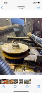

I didn’t . There’s no give or flexibility after I removed the locking ring. So am I to assume that I compress the fan and then reinstall the locking ring? I soak the area with Blaster Spray hoping that lose it up. This is very frustrating.

all I see in the image is a dirty pulley and a shaft sticking up with a slot for a snap ring. Is the fan under the pulley? What am I supposed to be looking at? FWIW when I take things apart I usually clean them, inspect, ( and maybe paint) before putting them back together. Your photo was so small that I had to blow it up to see it, and that makes it blurry.

Thanks for your input. I have struggled with this replacement and have also reached out to Tuff Torq. Apologies for the photo quality had trouble with file . Basically what I have after removing the snap ring. Appears to be a washer followed by some plastic core around the stem when I removed the snap ring. Wondering if the plastic I’m seeing is the core of the previous fan. Thinking about trying to remove the plastic ring to see if this allows the washer to slide down the shaft so I can install the fan. Thoughts?

gotta remove what is left of the old fan before installing the new one.

I think I’ve removed most of the old fan. Assuming after removing the stop clip the washer would just pull off. The washer is moving at all. I’ve soaked it overnight with WD40 no luck. Very frustrating.
