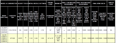

Yes I said manuals do have printed mistakes like in the case of the Tecumseh L-head manual a half truth as it assume both carburetor styles are tuned the same. If you note the last image is a Wabro make and model specific tuning. Each make and model carburetor will have different tuning procedures depending on what it is on. Some manual errors are translation errors too.
