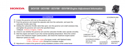

i would begin by performing a governor adjustment

1652060513631.pngDon't worry about the torques

Thank you for the resource. Will get to it later this week and let you know how it went.
