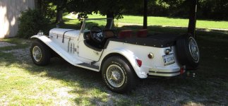

Not to drag you back into the oil discussion, bertsmobile1, but I use the T6 in my OHC Ford non-cat converter 2.5 engine that holds 5 quarts. The oil comes in gallon containers, so I have some on hand after an oil change. It's no doubt overkill in the mowers , but I know Ford had a lot of issues with high wear on the cam and followers due to oil issues, so I use the T6. It's going on 300,000 miles so far.
