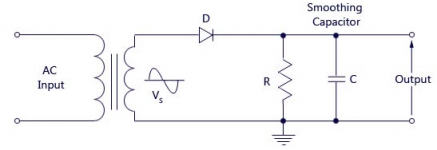

Since I haven't seen this setup I can't be specific about the charging system but it does appears to be a pulsed DC system. Most meters only reads average RMS voltage even when reading DC voltages of this type so the reading will be lower; although, with the battery in the circuit it will be smooth out to closer to pure DC due the capacitive loading effect of the battery. The battery is such a large capacitor you never reach peak impulse voltage until it is fully charged. You can not get an accurate reading without the battery attached. Plus your test needs to done at full throttle, readings at idle will be lower.
