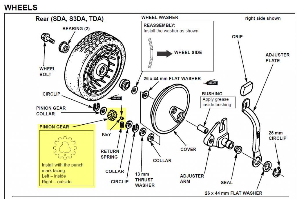

First, I have no backwards movement ability unless I pick up the back wheels. When I roll forward, I hear the pins clicking, yet I can't pull backwards at any time, whether running or not.

Binding while trying to roll backwards could be debris/rust/junk in the drive ratchets. Should tear down each wheel assembly, clean, inspect, replace worn-missing parts. Pay close attention to the pinion gear, key and grease it when reassembling:
No drive? Belt engaged, turning input pulley to the trans, and cable adjusted to confirm arm on transmission is moving? Then yeah, trans is probably gone. No service parts for it, you just replace as a unit. Part Number is 2001-VG4-HO2, list price is $109.97.
