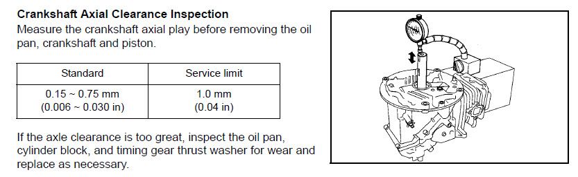

Can you tell me what the endfloat should be on the GCV160 crankshaft? I am convinced this knocking is related to crankshaft endfloat ('drift')
robert@honda
Nov 2, 2011
97
1,791
:wink::tongue::wink::laughing::wink::laughing::tongue:
