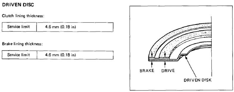

That mower is likely 20+ years old, so wear items like the clutch/brake lining come to mind. For example, the driven disk has both a brake and drive service limit:
Even if in spec, could be warped, damaged, etc. It is normal for some engagement noise to be present, but you say it is "strange" so I'm guessing it has just starting making this noise, and you know from owning / using it a while it does not sound normal?
