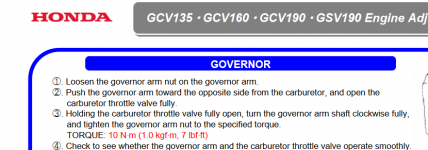

Usually a engine that is running too fast, is doing it because the governor is no longer governing the engine. I would first perform a simple governor adjustment.
Don't worry much about the torquing the nut, just get it good and snug, and be extra careful when handling the governor shaft, as it could be pushed in and fall into the crankcase.
View attachment 59697 View attachment 59698
Hi,
Yesterday while I was trying to obtain some valid information this issue I think that I remember discovering an actual honda engine manual that had this same diagram shown in it, by chance is this what you used to display this image ? I'm also thinking that the carburetor might possibly be dirty / gummed up due to unleaded gasoline. My neighbor had her son try & look @ her mower over the weekend, he watched a couple video's on you tube about honda mower engines running too fast, I think that I remember him bending the governor arm just a little to put more slack in the governor spring. I don't think he hurt anything by doing that, of course your opinion is always welcome. Stay Safe !!

It was just the one page from honda, https://cf.hondappsv.com/files/OP/O...GCV135_160_190 GSV190 Engine Adjustment I.pdf
bending the governor arm forward, or back to adjust RPM faster or slower, shouldn't hurt anything, but it shouldn't take much of bend to make a noticeable change in RPM, so it kind of sounds like the Governor assembly inside the engine may be toast, but we'll confirm that when you adjust the governor per factory instructions.

Hi,
Today I did my best to try and get my neighbors lawnmower to idle properly. I removed the carburetor twice, to me it seems like the throttle plate is gummed up / frozen in place. Trying to adjust the governor was a waste of time because it didn't seem to want to move at all. She's going to have to consult someone that has more knowledge about lawnmowers than I do. At least I made an effort to try and help her. Thanks again for all of your help. ?
