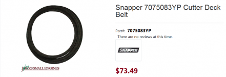

is the main drive belt supposed to be a smooth V belt or the v belt with teeth?

If you mean the engine PTO to deck then it is the following.
Which appears to be a cloth covered belt and not a cog belt.
