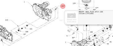

I went out to the barn and Hydro fluid was under my mower. 60" Maverick k. I think a 2021 model. Anyway...jacked it up...there's a plug missing out of the side. I looked at the other side...it looks like a black plastic plug belongs in there. What do i need to buy? To replace it. Thank you.

Really need the model number off the transaxle to be sure but if yours is the 2021 model it should be Hydro Gear seal PN 55177 that for the internal brake shaft. Easy to replace.
Post the transaxle model number its serial number tag and I can look it up on the HG dealer portal.

Well it's a 2020 model....I measured the diameter of the hole...it looks like 7/8 inch.

7 / 8 = .875
1 / 4 = .250

No I don't as I never needed one. I yet to see one fall out. If I do then I order extras.
Even my main distributor don't have them. And Gardner only has one in stock but I dropped them.
But here is one online shop that has them in stock. Higher than the suggest list price.
https://mowpart.com/seal-plug-875-55177/?msclkid=301520d83fe01247aa2a486dfe0c81ac
