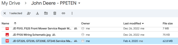

Bert if I got my info right you do have access to the TM over on PPETEN under bert***********rs. I had added it back in 2020. Now it is a fairly large file.
But the GT245 uses 12v through the seat switch to activate a relay. These switches do not like 12v running through them due to the current involved so they tend burn the internal contacts and become non operational. The switch should be black in color indicating it is a NO switch.
