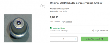

I have a LX178 and one of the grease nipples that lubricate the bearings on the cutting deck is missing. Are these nipples a press fit as opposed to threaded and it so does anyone know the size please?
64
24,705
in the actual housing they will be 1/4" SAE threaded
In the spindle itself they are a press fit & not replaceable
Usually when they fall out the threads are damaged beyond use so you need to tap out to the next size up
Spindles can be tapped as well but you need locktite them into position.
79
10,271
Well I going have to disagree that it threads in. According the image PN JD7849 it is a press in (Driven in) version.

my bad, my eyes failed me.. thought they were threads cut on that zerk.

If it is the spindles you are greasing from the side, the grease does nothing but fill a void. If the grease nipple is on top, it likely unscrews when it hits the frame when deck is raised.
enigma-2
Aug 8, 2012
194
They're not really grease nipples. They're just vents. If you look carefully, you'll see that the check valve is missing. There's only a hole going all the way through.
When you think about it, it makes sense. The bearings are sealed and can't be greased.
I talked to an engineer who worked for a major manufacturer years ago about why they do this. He told me that when they went to sealed bearings, they eliminated the grease fittings. The customers and dealers had a hissy about how to grease the deck bearings. They explained that it was no longer necessary but fell on deaf ears. So they installed these vents to allow any water that go into the sleeve to vent out. (At least that was the theory). They don't recommend pumping grease into this fitting as it will eventually dry out and attract water.
As for your condition, you need to close the opening to prevent water or dirt from entering.

Hmmm, Looks there are steel ball in there to me.
