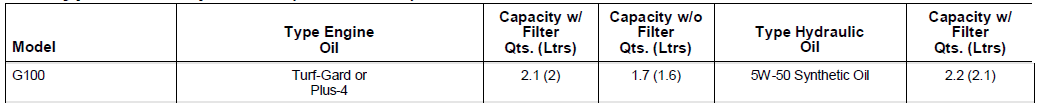

Whoever has a Deere database, can u tell me how much trans fluid the G100 tractor K66C(at least that's what I found online) transmission holds?
I find conflicting numbers online - 1 quart 2 quart, 1 drain bolt, 2. I drained mine and it takes 1 quart and upon shaking the tractor, I see the fluid sloshing around so it IS full(after driving it varying speeds to purge air).
TIA.

*UPDATE*
Looking underneath the trans, I found some numbers and looking up pictures of the numbers I found, it is NOT a K66 trans after all. From a video I found, It is a K62 and it DOES have 2 drain bolts, so now to change the other side...
