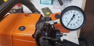

2cycle engines must us 89 octane or better, has less heat than 87.
Say what????????
I have about 15 2 strokes all running 87 regular. 2 of which are chainsaws running 195psi compression and advanced timing with ported cylinders.
