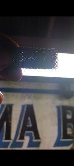

Happens all the time with trimmers and blowers. Easy to diagnose and fix.Presented with hard starting, rough running, wouldn't throttle up. Smoking.. dumped out and added my 50:1. No change.
Problem: spark screen clogged.
Cleaned screen, and muffler, new spark plug, and tuned carburetor. Running good now.
