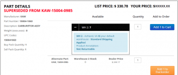

Now that is confusing as I was using the EU website. But this might put thing in perspective as this is from my Kawasaki distributor as PN appears to be superseded to the PN I gave.

Yeah, they keep updating the part numbers and the price. Has anything really changed other than the part number? I doubt it.
