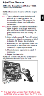

Where would I find the information on how to adjust the valves
121
12,890
Note: The intake valve is the one closest to the PTO end of the engine, not the flywheel.
