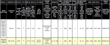

@StarTech I did say it was an echo 225. And I still don't understand how tuning it would get it to start after I'd already tried starting it with the adjustment screw in all positions. Could you tell me basically what the tune up procedures are for these if it's any more that playing with that screw?
I'm only in here to learn but my brain doesn't take instruction well, just explanation mostly. And my focus is on basic operation cuz if I don't get what's going on you'll see me again too soon.
Turns out it was just flooded. But I would like to know the tune procedure if there is more to it than just adjusting the screw. Is there something else to adjust?

* is 2.5 mm wide flat screwdriver.
