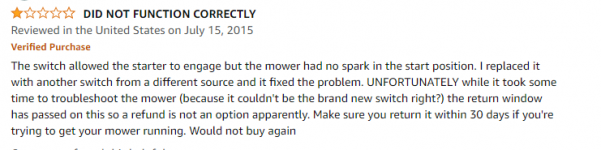

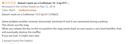

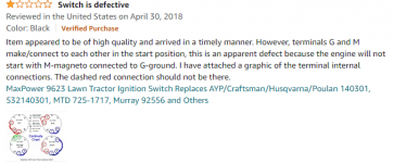

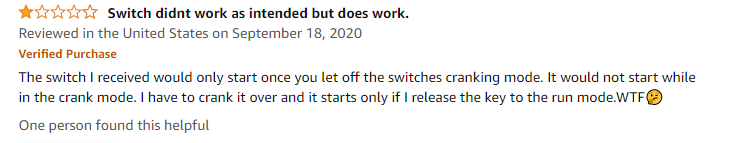

Below is the ignition switch contacts and wiring for the 92556 switch and also a few random reviews from different brand switches that are "suppose to be" exact replacements for the common standard 7 terminal Murray and other mowers of the 2000 era.
MurraySwitch.pngAmazonReview.pngAmazonReview2.pngAmazonReview3.pngAmazonReview4.pngMurraySwitch.pngAmazonReview.pngAmazonReview2.pngAmazonReview3.pngAmazonReview4.png

It's actually B+L+S AND M+G terminals making contact in the start position. Its almost like the switches are in the start position and off position at the same time other than the "L" does not make contact with M+G in the "Start" position as it does in the "Off" position. The terminals are lettered on the actual switch just as in the picture above.
