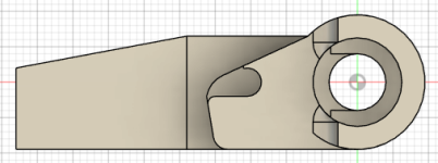

Wanted to share some pics of my 3d printed part, just installed it decided to screw it so it would be easier to replace if it breaks,
lets hope it holds up, if not I'll probably be ordering same model you found.
I am always amazed when someone "manufactures" a part.
The stress point will be the attachment of the new piece to the door.
Glued and screwed may be needed to make the attachment.
This design uses a peg or a pivot on either end for attachment of the door.
A similar design uses a long thin metal rod as a pivot that goes the entire length of the front edge of the door and engages the handle bracket.
IMO that is a better design. I think it is a more expense designed versus the two pivot design. Just a guess.
