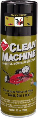

I have gator blades and a mulching baffle on my JD. In March I pressure washed underneath the deck & sharpened the blades, then treated the bottom with this:
I have mowed my 2-acre yard every week since then without cleaning or sharpening, and it passes the yard boss's (my wife) critical inspection.
That spray Teflon is pricey ($20), but I should get a few treatments out of it assuming the nozzle doesn't clog up. D@mn stuff was likely 10 bucks 3 years ago.
Good luck & Happy mowing!
